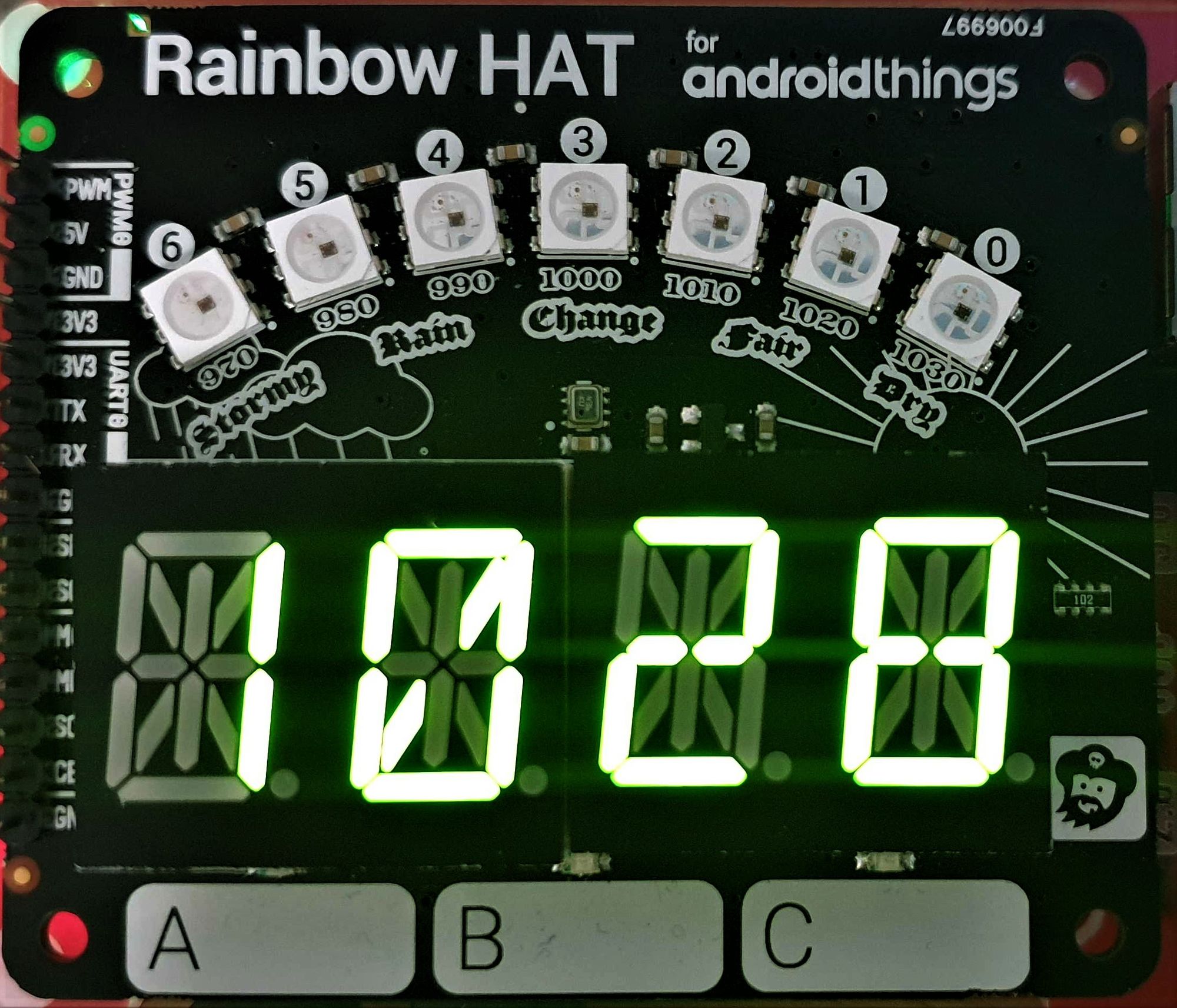

Run the code
As before, run your code and look for a reading on the display. Normal air pressure is around 1000 hPa, but it depends on the weather. Find out more here.
