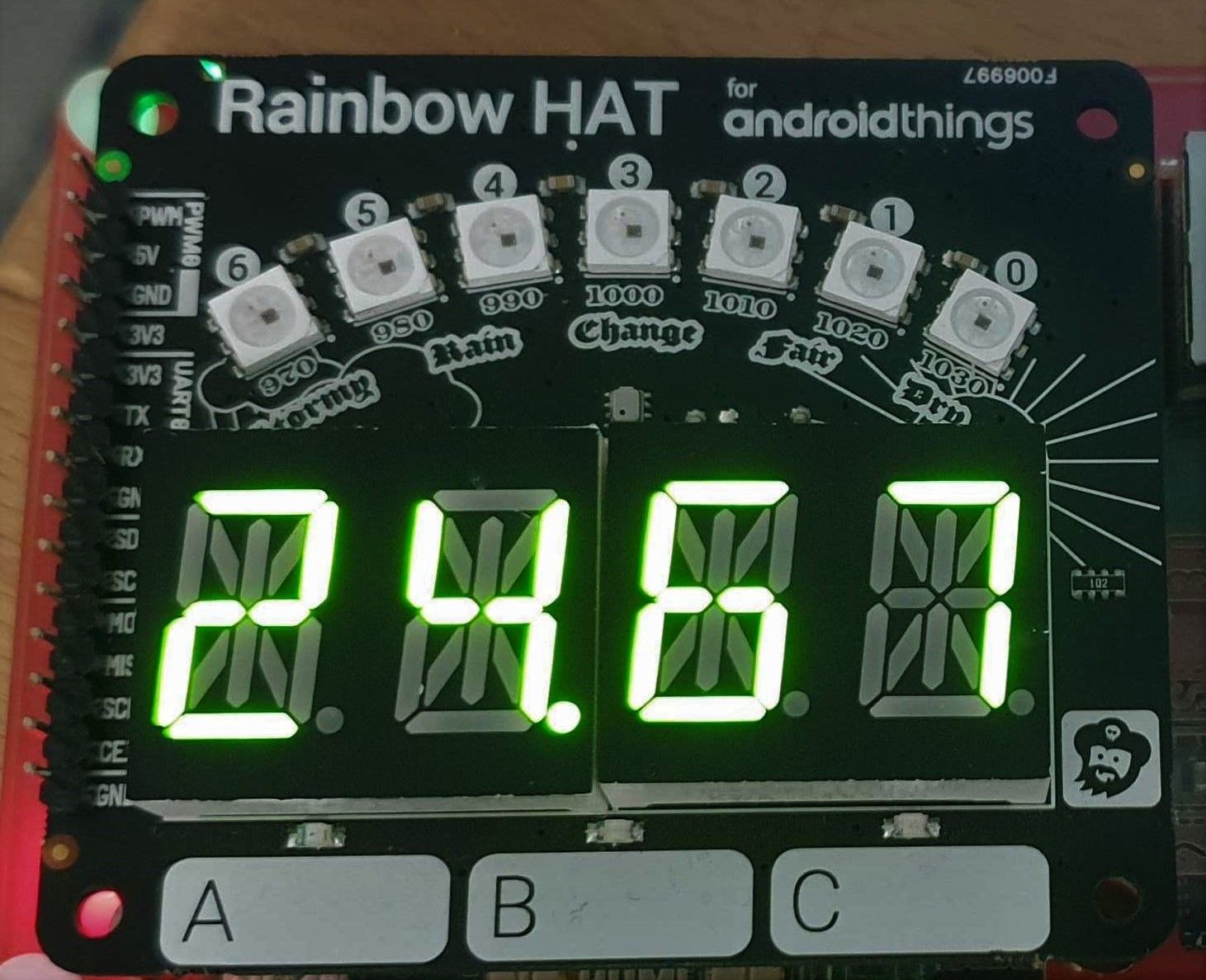

Run your code
Run your code by pressing "play" in Thonny or Mu. You should see the temperature appear on the display.
![](https://edu.pimoroni.com/content/images/2019/12/temp2.jpg)
