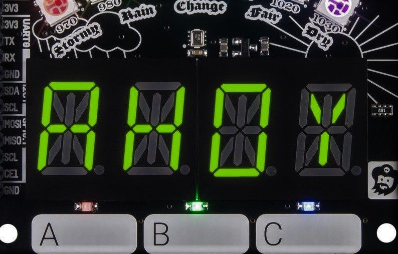

The display on the Rainbow HAT has four blocks, and each block can display a character. If you look closely there are 14 little segments and a decimal point on each block.
For this first task, you need to think of a four letter word that you can display in public!
We chose AHOY in this picture but most people choose "Test" when asked for a word to test it out with.
We have darkened this picture of the display showing "AHOY" because it's hard to see when it's so close up!

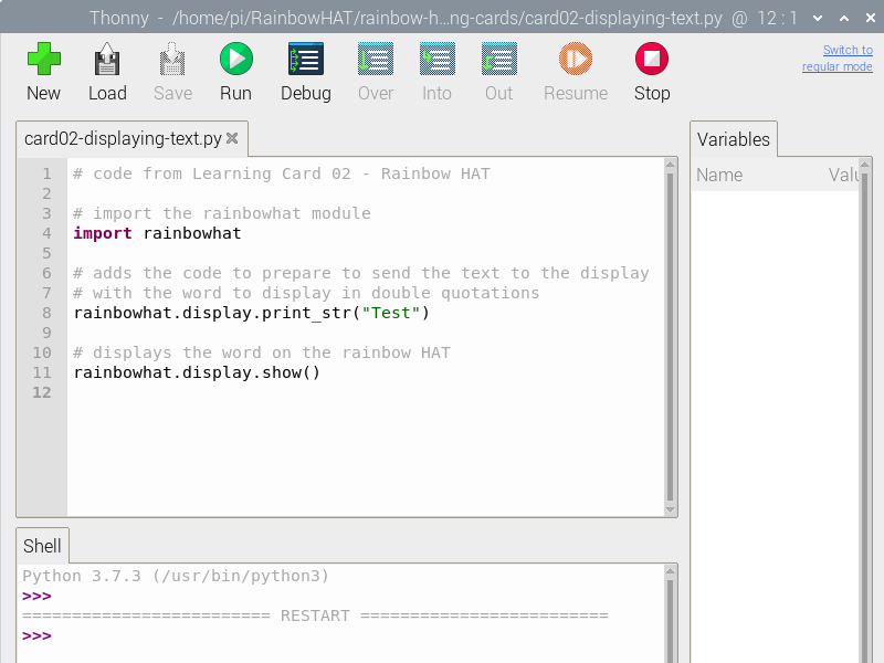

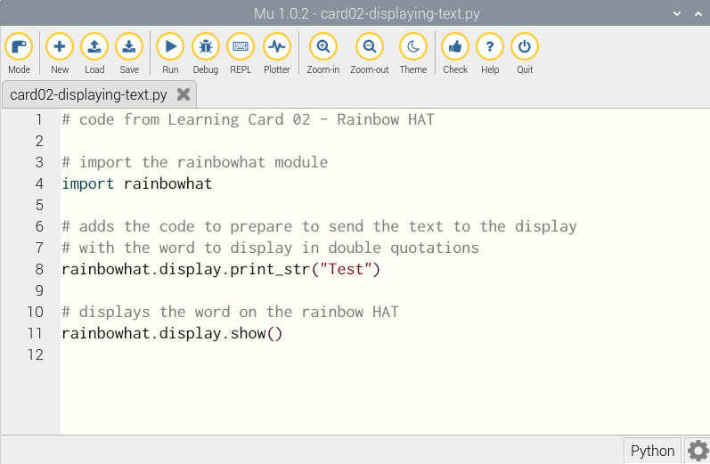

Type in these lines of code:
import rainbowhat
rainbowhat.display.print_str("Test")
rainbowhat.display.show()
The first line tells the code to use the rainbowhat library we installed earlier.
After that, we talk to the rainbowhat, to the display specifically, and ask it to print the string "Test", which puts the word "Test" into a buffer ready to use.
We have to tell it to show the contents of that buffer, which is what the last line does.
Run your code
Once you have typed in your code, run it (in Thonny and Mu, press Run). You should see the word "Test" appear on the display.
In these screenshots you will see we have also made comments (the grey text with a # before it) to explain what each part does. You do not need to add comments but it helps people reading your code to understand what each part does.
The displaying text program on Mu
The displaying text program on Thonny
