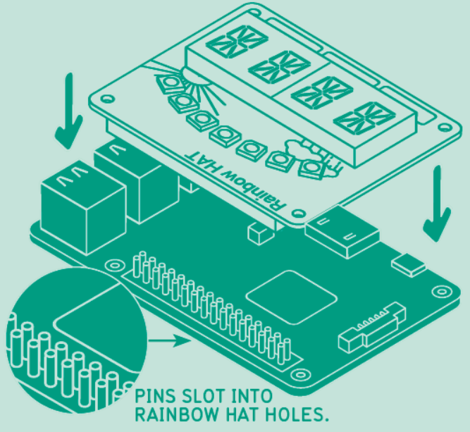

Put the board on the Raspberry Pi:
Make sure your Raspberry Pi is switched off before you do this step.
Under the Rainbow HAT is a strip of holes called a header, and this pushes on gently to the pins sticking up from the Raspberry Pi. There are exactly the right number of holes for the pins, so if you can see any pins sticking out either side, then you haven't lined it up right and need to try again.
The HAT sits on top of the Raspberry Pi. There are some holes to the left of the A button and the right of the C button that you can put some little supports called standoffs in (available separately), but it isn't necessary unless you have POE pins (four in a little square) sticking up which might touch otherwise.
