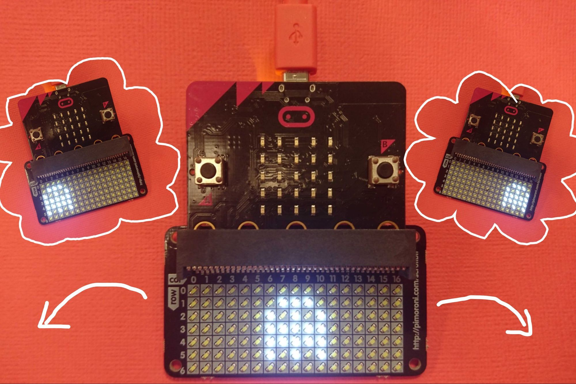

In this activity you'll learn how to use the built-in tilt sensor on the microbit to make an icon slide across the screen (and not fall off)!

Select tilt left and then we can start putting the code in. We know that if the ghost is all the way over on the left, it's starting in column 0. Therefore, we can let the code make the column smaller, as long as it's bigger than 0, without the ghost falling off the screen.

When the ghost is on the right edge, the start of the icon (the top left) is in column 12. We now know that we can keep increasing the column number until we get to there, which means we can keep increasing as long as the column number is less than 12.
5. Putting all three sections together. Now you have all three sections, you can download the code to your micro:bit and try it out!
