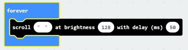

2. Choose this command from the scroll bit menu, and drop it into the forever block.

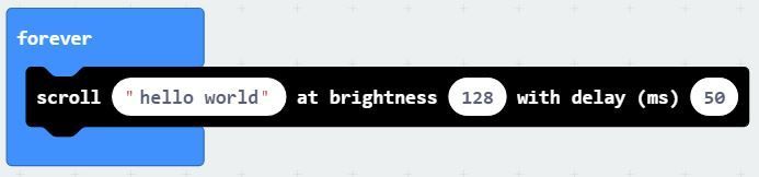

3. Type “hello world” (or whatever you want your message to be) into the box between the quote marks.

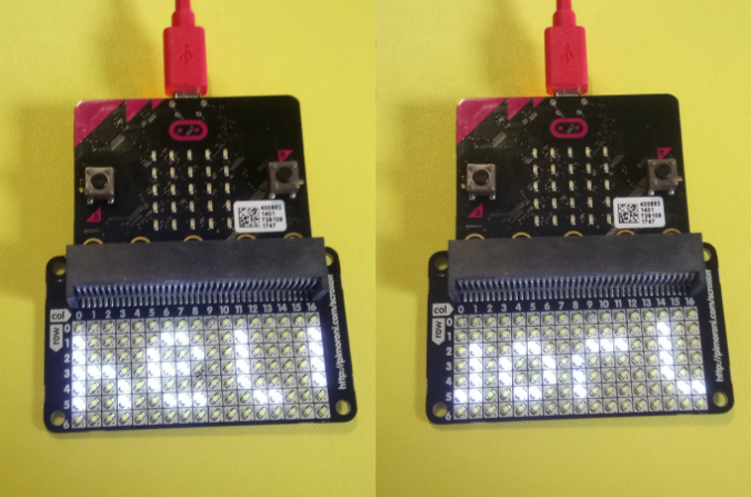

4. Download your code and flash it onto the micro:bit by dragging the saved file onto the micro:bit file system, and watch your message scroll across the screen!
