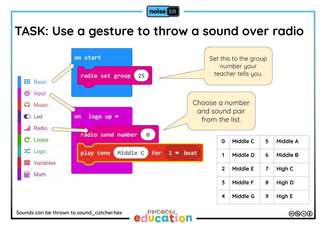

We made a a "sound catcher", which is a micro:bit hooked up to a speaker (in this case the noise:bit) and listening on channel 25 (because Christmas).
The activity is to program a micro:bit to send the right number for a particular note to the sound catcher, and in this way you can either play a tune using one micro:bit and lots of gestures, or many micro:bits using the same gesture.
If the sound catcher is on Channel 25, remember all of your senders must be on Channel 25 as well!
We made our senders play the tone locally as well as sending to louder speakers. You might want to make your senders display a picture of a note when they send a signal, or perhaps display the letter of the musical note they are triggering. Just replace the red "play tone" block.
