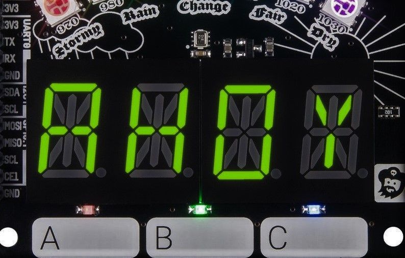

The display on the Rainbow HAT has four blocks, and each block can display a character. If you look closely there are 14 little segments and a decimal point on each block.
For this first task, you need to think of a four letter word that you can display in public!
We chose AHOY in this picture but most people choose "Test" when asked for a word to test it out with.
