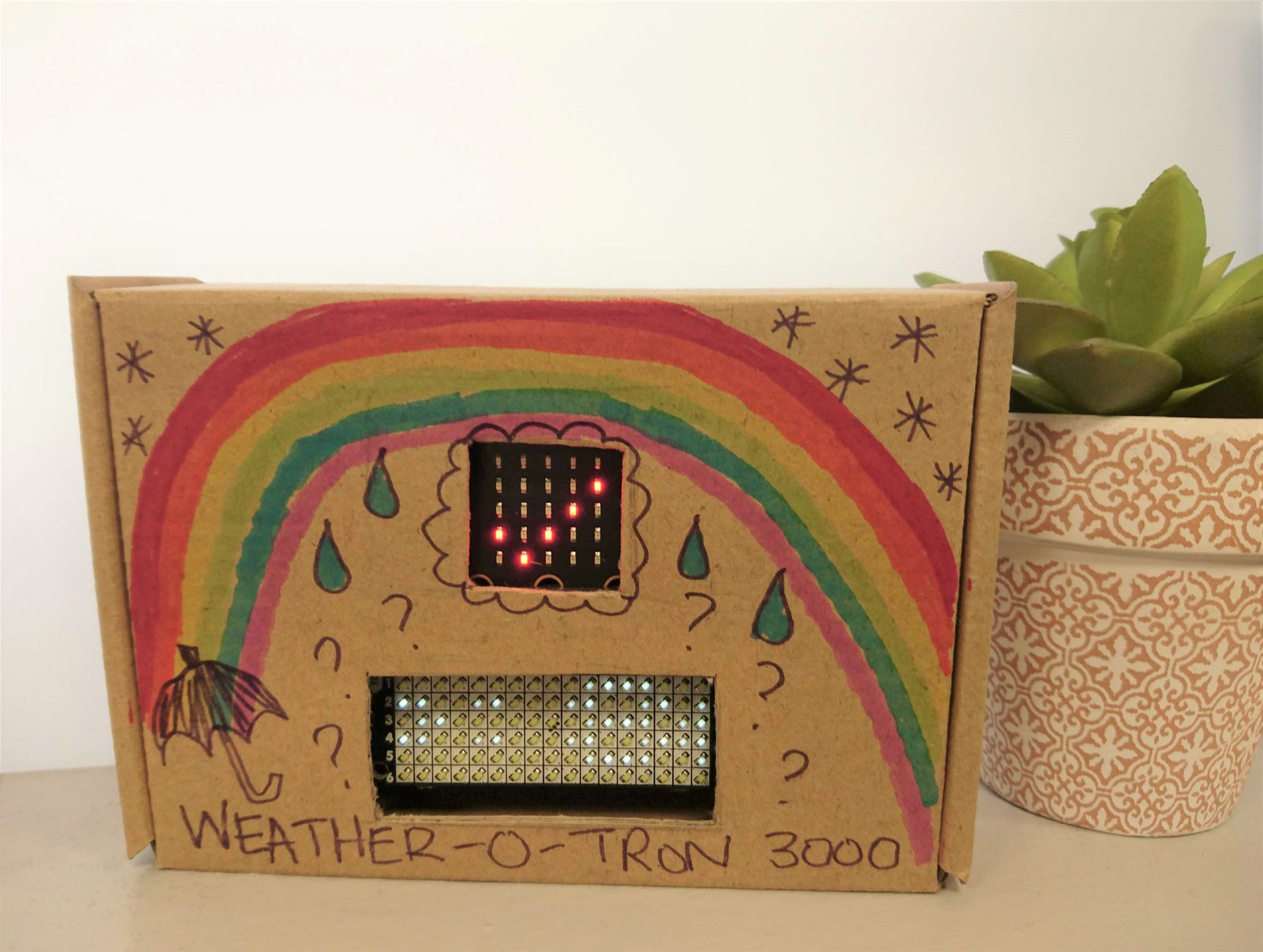

How to code the inside micro:bit
Firstly, we need to set up the radio channel to be the same as the channel the other micro:bit is sending on. Make an "on start" block with the channel instructions in like last time.
This time, instead of "forever", we'll use a block that does something when it receives a radio signal.
That received number is the temperature, so we need to show it on the scroll:bit. Add in a block to scroll some information.
This is where a useful block called "join" comes in. It hides in the advanced menu, under text.
We can use that block to join the text and the numbers together!
You'll see that you can add or take away items to join together - we'd like three spaces so just click on the plus button.
We've typed "Temp: " in the first gap. Note that you might have to mess around with spaces in the text parts to make it look nicer. Next, drag the "receivedNumber" block from the Variables menu into the middle space, and type "c" into the third space.
As before, this will work as it is, but adding some icons to the micro:bit screen helps you know when things are happening.
Now, house your inside micro:bit in whatever you like (or leave it on the table, up to you!).
It is a good idea to test that everything works before you go and put a micro:bit outside. Sandy stood inside with one micro:bit while I went outside with the other one, so that we could see how far away it would work.
